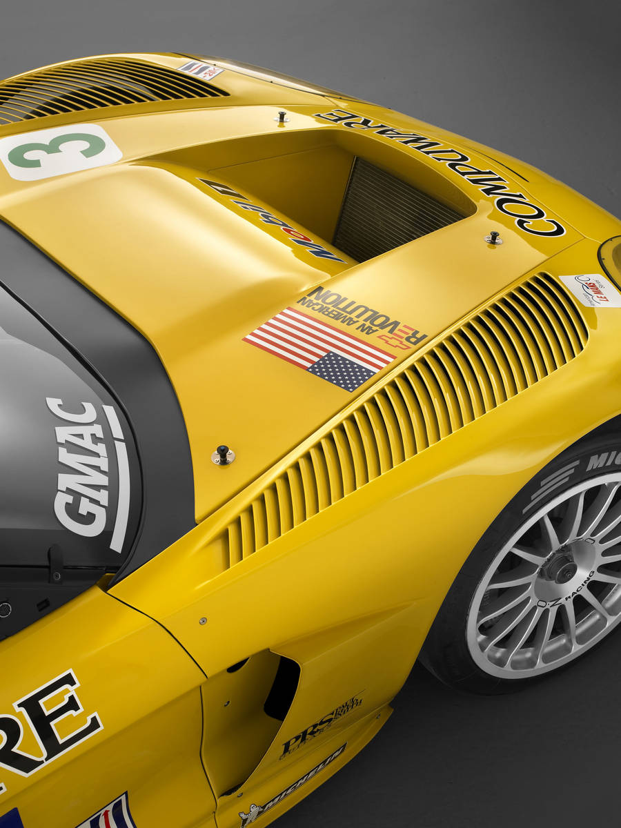

Would hood vents and louvers really pull a lot more air out?
Depends on the vent or louver. At speed, typically, no, as the air pressure on the hood and windshield is far greater then inside the engine bay. The air acting on the hood (higher pressure) would simply push it self into the vents to equalize pressure between the engine bay and the outside air.
You could use NACA ducts to over come this imbalance, but you would not be actively cooling the engine... just the engine bay. If I am not mistaking, the venting on the GTR is for cooling the engine bay at rest.
If you could incorporate this, then you'd be actively assisting in cooling at speed.
